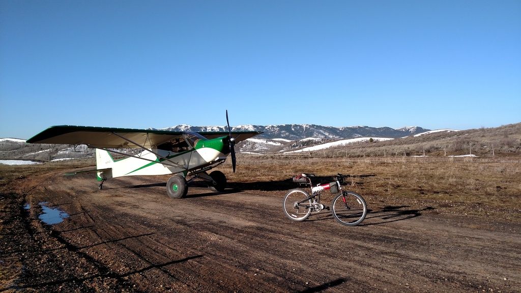

I have some hard numbers on what seems to be the range of the bike now. Until I installed the use specific watt meter I now have, all I had to go on (pun intended) as to battery state of charge was a cartoonish icon of a battery, that would slowly disappear. The watt meter nails it down to the fraction of a watt.
I rode into town from the Preston airport the other day, about 4 miles one way. Landing here, and several other sites on the way. This is how a snowboarding/E-bike riding/ ski pilot leaves tracks :twisted: 7K plus alt. both sites.
On the way in, I set the assist level (handlebar on the fly adjustable, 0-5, it adds a certain amount of electrical assist when it senses you pedaling, the more you pedal the longer your range) to level 2, and pedaled....but it was very easy pedaling thanks to the assist. Like I had a strong tailwind, not really work at all. I kept the speed right around 20 mph (it has a digital speedometer) as even bikers suffer from drag, and there is a big difference between 20 and 30 drag wise, the drag quadruples as the....., blah blah. Once at the cafe, I found I had used
35 watts, that worked out to 10.6 watts per mile covered. On the way back, I sat on my ass and played motorcycle, using the thumb throttle to set the speed again at 20, using the same gearing I had used earlier. You don't want to lug the motor, it likes high revs, it's totally silent no matter what, eerily so. I used 129.5 watts doing it this way, with no pedaling at all. That's 32.5 watts per mile.
A little math shows that I have a total of 600 watts (more or less) available in the battery I have, and I can get bigger, smaller, or another of the same size. So, if I play motorcycle, at 20 mph, I can go about 18.5 miles. If I help out just a little, I can go about 56 miles :shock: This should be more then adequate for my needs, though all these numbers are subject to wind, road surface, and most of all a heavy hand on the throttle (it's too much fun to resist going faster at times) I for sure should be able to haul ass at 20+ mph 5 or 8 miles into wherever, and back out, on a single charge, without pedaling at all. Recharge takes 2 to 4 hrs, dependent on several factors. A partial charge doesn't hurt anything. If it's the end of the day, and I'm over nighting somewhere with power to handle the recharge (less then 1 KW, call it a dimes worth of power) , it'll be pedal to the metal, efficiency be damned. If I have another stop or two planned and need the range, I'll pedal. In fact I'll probably pedal most of the time, as it's so effortless, not really work at all, and the payback is so great. So far the main reason I don't pedal every now and then is see if anyone notices anything odd about a bike really moving out on level ground with no movement by the rider, it's fun too. Crap, another expensive hobby #-o
